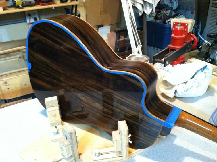

Project 1 is to start refinishing the treble side of the first steel string guitar I built in a class almost four years ago. The back and sides are Macassar ebony with wild grain which meant the sides didn't didn't want to bend evenly and ended up with a lot of topography that had to be sanded out. That turned out to be a solid lesson in the importance of good surface prep because I ended up sanding through the finish in a couple spots. At the time, I didn't want to delay the final phase of the build by redoing the finish so I went ahead and completed the guitar. I removed the finish yesterday and got the wood nice and flat and put the first coats on.

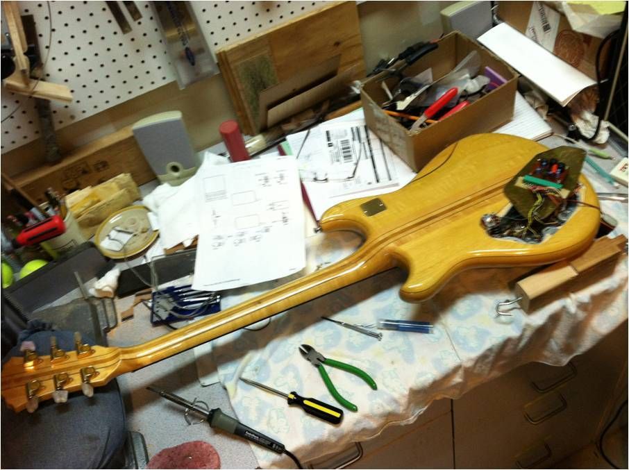

Project 2 is the restoration of a 1979 Ibanez MC500 Musician. These guitars came with active electronics including 3-band EQ and a gain amp. A previous owner removed all the active electronics and converted it to a standard Les Paul control set up. [headinwall] This model was built in relatively small numbers and the ones in the natural finish are hard to come by and highly valued. I bought it cheap and fortunately the owner had inherited the circuit board and the special pots for the EQ. The wiring in the control cavity looks like a bowl of spaghetti. The circuit board alone has 14 pins with 21 wires attached, but I have a wiring diagram and an unmodified MC500 to refer to. These are cool guitars and I'm looking to getting it back to where it belongs.
